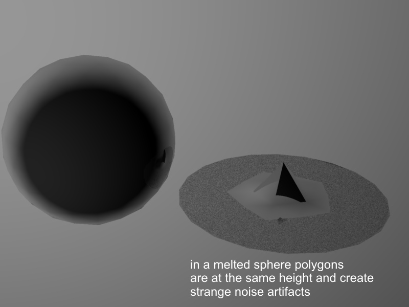

    I just used a "Melt" modifier on a sphere with a reflecting/refracting VRayMtl.
    Where the polygons are at the same position/height a strong noise comes up,
    probably because VRay doesn't know which polygon comes first...
    Is there a parameter to prevent this behavior of the renderer?
    Thanks in advance, Robert
    You can try setting the "Secondary rays bias" parameter to a small positive value like 0.001; also make sure that the material is double-sided, and, if reflective, that the "Reflect on back side" option is enabled.
    Vlado
      Thanks Vlado! "Secondary rays bias" helps, "Reflect on Backside" had no direct influence...
      Best, Robert
        You could probably put a push operator with a really small value on top of the melt modifier too - it'll force the polygons away from each other a tiny bit.
          @joconnell: Good idea, but it isn't specifically about "Melt", but any
          transformation that causes such overlays ... the Ray Bias works great.
