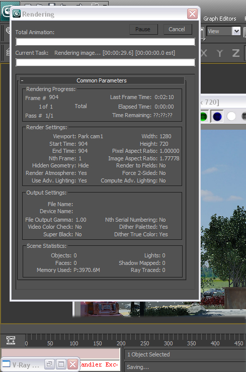

        This same exact thing actually happens to me quite a bit too. I noticed the other day that max did a quick save every time I hit render, but sometimes that save would lead to the light cache hanging.
          Crap...I just had to say something. Here is a screen shot of both rendering and saving at the same time. By the way, I did not ask max to save, I only hit the render button.
