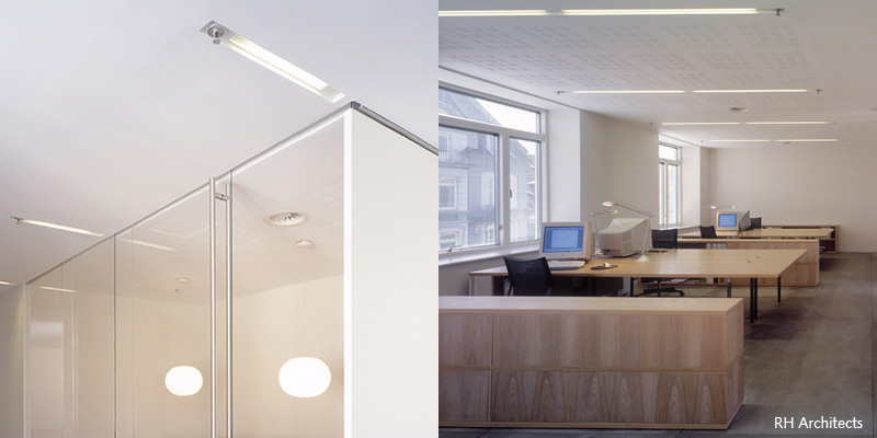

      To davision: My point is not to have the light looking as bright in the day scene as in the night scene, as I am aware that the longer you expose the brighter the image will be - and vice versa. My point is to have the light behave/look real, whatever exposure settings I use. In this case I expected the light to be looking much dimmer in daylight, but not to disappear almost totally. The lamps are placed in a dimly lit corner, and my real world experience tells my that you will be able to see some direct light on the wall and table, and also in the reflections on the table surface.
      To samuel_bubat: My materials are pretty correct, the wall have a reflectance of 80%, the floor 65% and the furniture (light oak) an average of 57%.
      I have provided a couple of real photographs from RH Architects below as a reference. The left image shows the Glo-Ball lamp I used in my test renderings. The right image shows that even though there are a lot of light coming both through the windows and from the recessed light in the ceiling, the light from the table lamps are still pretty easy to spot on the surface of the table in the front.

        Keep in mind that professional photographers use a lot of tricks to get a good image. What you're looking for in terms of reality in your digital images, is not what you see through your eyes in real life.

          Also, the one real photo on the right only shows sky light coming in through the windows, unlike your rendering which has direct sunlight. To me, the problem looks like your glo-balls are too dim in the night time render. They should be brighter and your exposure should be shorter.

                    Looks correct to me. The exposure difference between the tungsten type lamps for the night shot is something like 8 stops different than the daylight one. You would expect the diffusers on the lamps to be quite greyed out.
                    The photo reference is deceptive because they look to be pro shots which may mean some good light/exposure balancing on set or retouching/processing to achieve that. Probably both. It would be more instructive to take a camera yourself and actually shoot a similar lighting scenario to see what you find.
