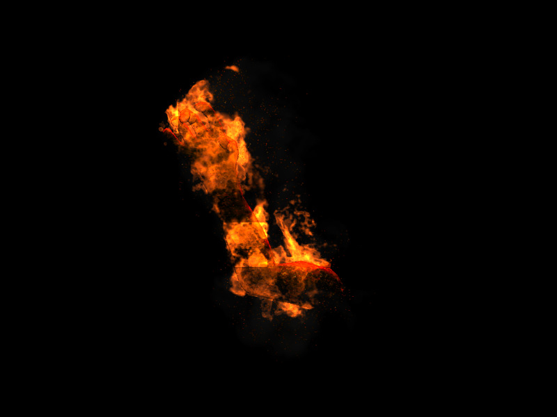

    FumeFX 2.0 and VRay 1.5 SP2 are rendering buckets screw ups (see attachment center and upper left corner)! Last time i saw that was with GI set to Bucket mode when multi core machines came up
    Any idea what could cause such a trouble? I rendered Fume in VRay many times before. What happens usually is that the smoke looses all shading/shadows when rendered in VRay and you have to switch the renderer and back to vray to fix it but this is new...
    The light is a Spot light with VRay shadows with 8 samples, Athmospheric Shadows is checked in the Shadow Parameters. Render settings are attached. No GI. Settings are pretty much default!

      Does it work correctly if you place an object behind the fire?
      Vlado
        i switched the renderer and then back to vray and it worked. teh vray > Fume/AfterBurn connection seams to be patchy sometimes. I had it happen more then once in the past where i lost my shading on afterburn and fume scenes and i had to switch the renderer and back to fix it.
