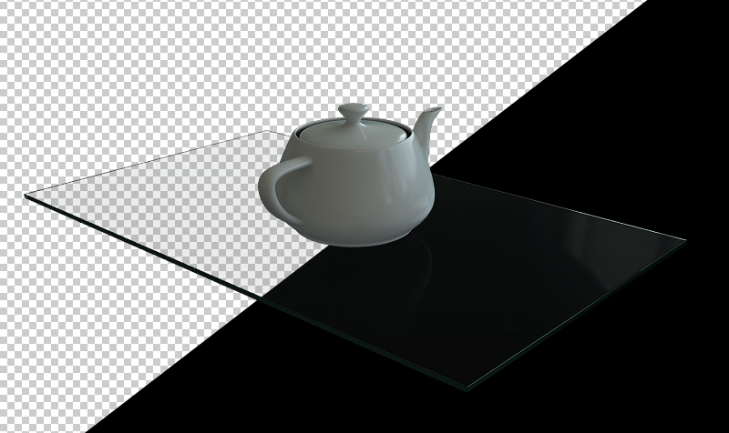

    I have a black environment background, and a glass object on a vray plane. After applying an alpha mask, the reflection/refection of the glass is black even though I am using HDRI IBL.
    In order to make the glass reflect/refract either white or the HDRI map which settings to do I need to change? As its glass I am not sure if its reflecting or refracting the black or both.
    Do I change reflection/refraction environment override and/or refraction environment override to the HDRI map or white.
    Or the exit colour in the reflection of the material as this is a default black.
    I have tried a white material in both the reflection/refraction environment override and refraction environment override and it still comes out as black
      Yes you need to drap drop you hdri map into both reflection & refraction slot of vray environment. If you can post render will help us know wht exactly happening thr..

        here is a render, you can clearly see the glass is black against the background
          Check in material affec shadows/ channel all and use vray alpha output layer to cut out ur models. That should give opcaity to ur glass...
          also u sure u have enough raytrace depth?
            chk attachment.. hope this shd help
            hdri in vray environment- Gi, reflection & refraction slot
            max environment colour - black, ( doesn't matter wht u keep here )

              I didn't have affect all channels, it was color only. Thanks!
