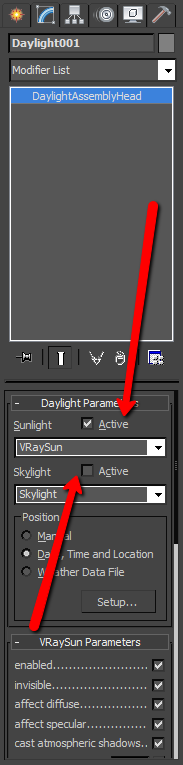

Hi whats the best way to animate a vray sun moving through the day....i am testing animation re-pass & render but it looks quite long winded...has anyone had any experience and could guide me to a quicker solution
