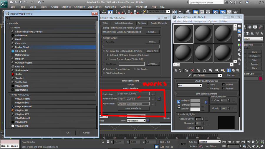

        Hello, thank you guys for the help. It worked, but only when I changed my Material Editor Renderer to version 2.20.02, which is not what I'm using for the Production Renderer. Shouldn't both match?
        I downloaded and installed the 2.20.02 version, but for some reason it installed 2.20.03 inside of 3Ds Max, and it's the only option I have to assign as the production renderer.
        screenshots:
ID:	844898Click image for larger version
          Yep, this looks about right.
          Vlado
            When I assign my production renderer to Vray Adv 2.20.03, my Material Editor Renderer is also assigned to Vray Adv 2.20.03. This doest not allow my map browser to work.
            When I assign my production renderer to Vray RT 2.20.02, my my Material Editor Renderer is also assigned to it and everything works fine!
            My question is, I payed for and downloaded Vray Adv 2.20.03, should I just use Vray RT version that came along with it? I'm new to Vray and I´m a bit confused.
