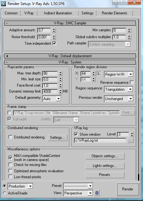

    Hi guys,
    Again I am having these problems. I just can't figure them out. I always use the same settings on my scenes, and every time I have one with reflective materials and dark grey colours I get so much noise on them. I tried using a high preset for irradiance but that gave even more noise, I guess due to higher max rate. Usually I just use medium setting. I also tried reducing adaptive amount from 0.85 to 0.7 but still not good enough. Since I use LWF, with gamma 2.2, shouldn't that take care of noise in dark areas? With the same setting as for the light scenes. Though even the lighter object, the one with BB1 has way to much noise for settings this high. Please help.

    your render setting images is so small that I can't see your settings

      Not sure what resized them, maybe because they were gif. Sorry, I reloaded them.

        yes, looking at it now

                              Sample rate isn't being very adaptive at all. Spread out your values more (you're using 4,8 ) try 2-10. You'll probably see render time go down as well.
                              For your imap, your samples aren't horrible, but they're not optimal. Maybe someone with more information could disect this one. I usually do something like min -3, max -1, hsph: 80, interp: 30.
                              Your DMC Noise threshold is VERY high (like insanely high quality). Set it to: 0.007, and your adaptive amount to .85 (the default) and show us what you get please.
