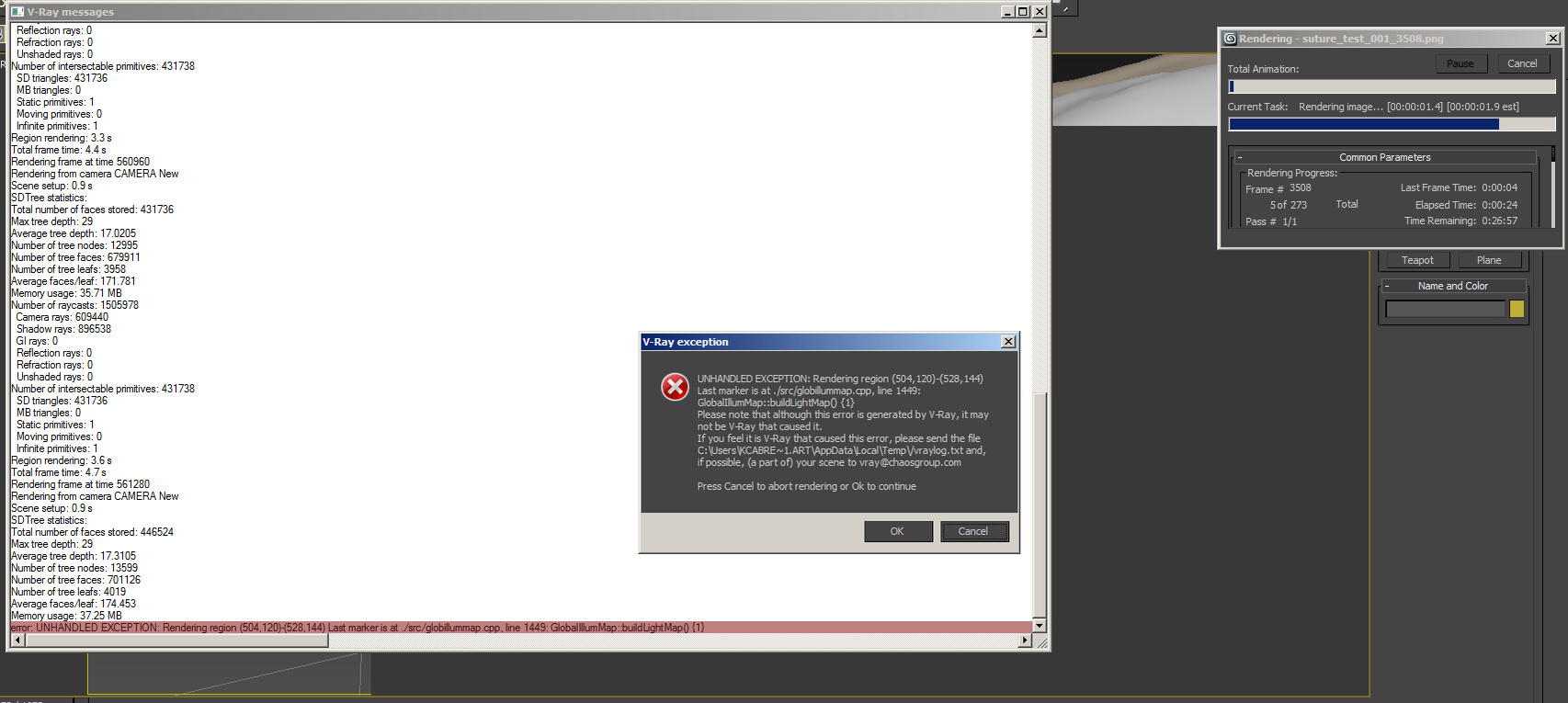

    Hey guys ive been getting this error in my scene i cant figure out why. have any of you ran into this error before

    What do you have in your scene (3rd party plugins?) ? Vray version ? PC specs ? Send us your scene ?
    If it was that easy, it would have already been done
    Peter Matanov
    Chaos
      i dont have anything third party, i am using vray 2.3, i have dual xeon 5620 32gigs ram and an nvidia 4800, but i think i fixed it when i was looking in the help files, i lowered the max. tree depth and raised the min leaf size and also raised the Face/level coef. I found that saved the scene and it rendered fine. I do have alot of tools in my scene that came from solid works that have triangles. So i imagine that was the issues when vray was subdividing everything. What i am trying to find out is why vray subdivided the objects upon render?

        We usually recommend to leave Max tree depth; Min leaf size and Face/level coef. setting by default because in most cases changing this parameters usually cause troubles.
        Also the subdivision that V-Ray do is for optimization purposes. More information can be found here:

          Hey guys never was able to figure out why i am getting these errors, but here it is again, same scene am trying to debug, we put it off for a while an now we came back to it. Any ideas?

            this really just means it crashed. Could be due to many factors, some of them can be - run out of memory, some bogus geometry, bogus normals, vray can have issues with certain modifiers, or if you applied displacement to bad geometry/faces. Cleaning up your scene could help...

              yea am actually doing that and it seems to be helping, am guessing its some kind of bogus geometry like you said, because it will crash on certain frames when new geo is coming in. Thanks for the info!
