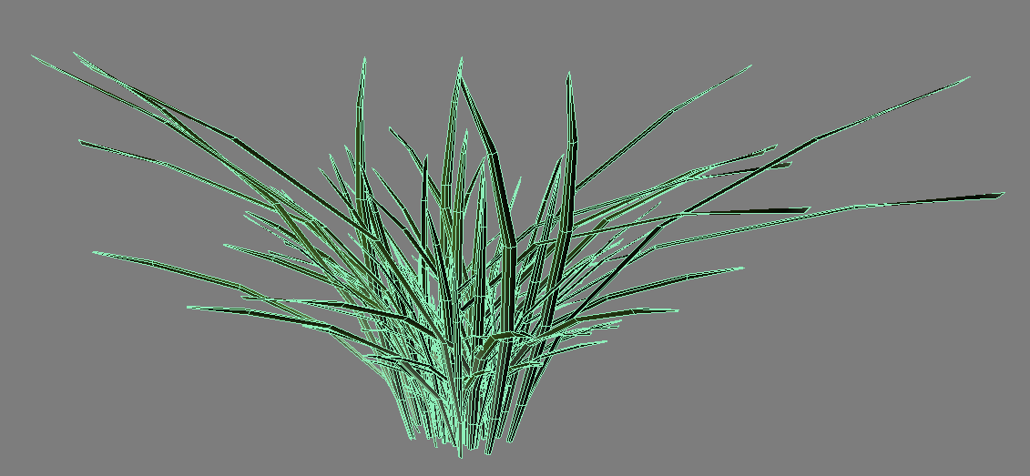

    So again, I'm doing test but I would like a theoretical opinion too.
    Also, tests usually end up in 7 hour render estimate so...
    Is it better to use MS to fill the area with like 5 million of these single grass objects (29 faces each-instanced of course), or to make a sort of grass bush (with 4396 faces) and 2 million copies of it. Math would suggest a single grass is better, but I'm not sure if vray/MAX/MS like 5 million copies of something.
    Also, if Vlado can shed some light on "unloading geometry". When I do these tests I usually fill up memory and get unloading geometry. If I hit cancel then, vray will sometimes continue to unload geometry for as long as 10 minutes. Why does it take so much longer to unload something than to load it?
    I set my dynamic memory limit to 5000MB, and have 8GB Ram.

                Everything working with proxys take a bunch of ram, i'm working each days on really big scene and each have grass. The last i've done is set to 42 000m² and i've to optimise everything in an entire day of tests...
                Mulstiscatter work approximatively like Forest Pack, i'm working with the two on several production, and if i'm using forest pack more than multiscatter now, it's just for the presets and facility to manage. Multiscatter is strong as forest to render billions of proxys as well.
                You have 8 go of ram, and i can be pretty sure that's not enough...
                For the first question, you can save your time anr ram usage in a tallest bush of grass, you can made a circle of 0.25m of radius with grass fields scatter on it, turn it to mesh and scatter again on your surface. Of course, bigger is your proxy, lesser you can scatter it along a path or road..., but you can done some limit to scatterise your "big grass" 50 cm far fot your road or path, and another with smallest grass proxy for the las 50 cm...
                In all... Everything eat memory...
