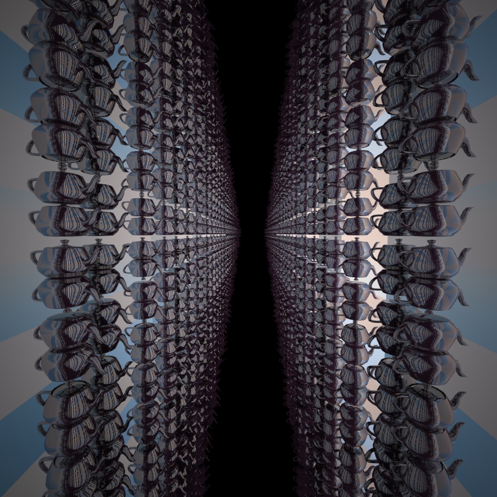

            I couldn't produce it either. In my tests the result from Global Switches set to 10 is slower than the result with 10 set from Material with 0.1 second.
            1. Material_Max_100_RenderTime_3m6.9s
            2. Material_Max_100_Global_10_RenderTime_1m14.5s
            3. Material_Max_10_RenderTime_1m14.4s
            1.Click image for larger version
ID:	8469132.Click image for larger version
ID:	8469143.Click image for larger version
ID:	846915 reflection_limit01.zip
