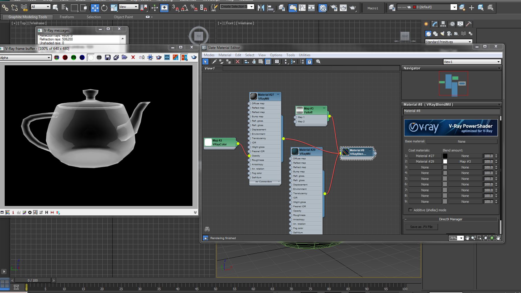

    As a workaround i have prepared a simple scene with VRayBlend material, i hope this helps you.
    preview:Click image for larger version

      Thank-you for the workaround. I had thought of that, but it's not quite the same, but at this point better than nothing. Thanx for the fast response. --ds
