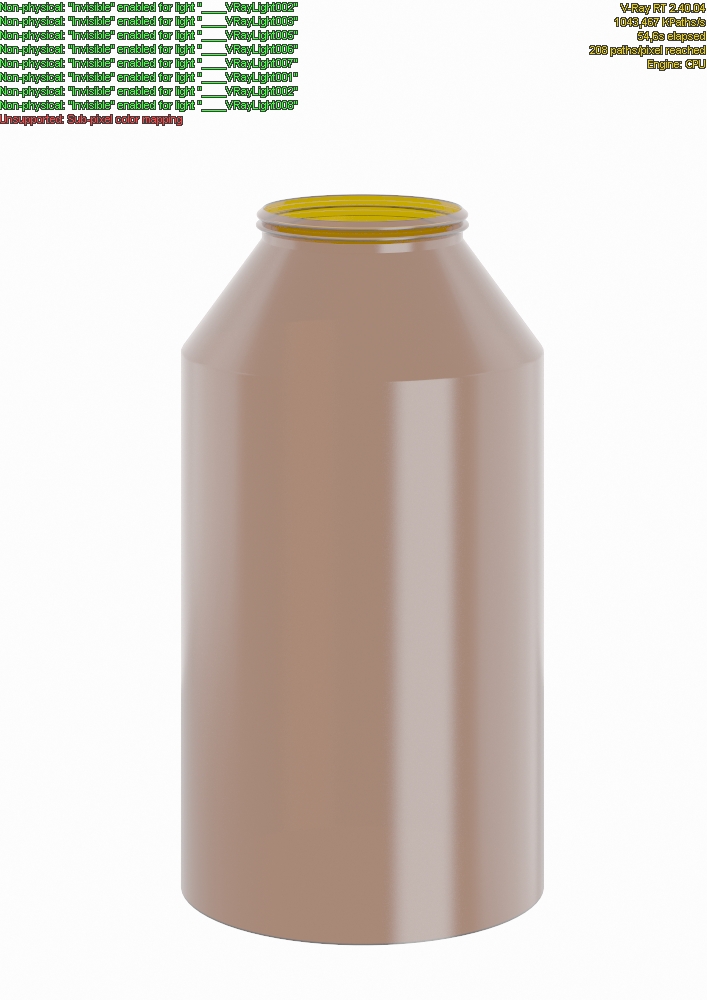

    Can someone please help me understand why there is a big difference between VFB and RT.
ID:	878468Click image for larger version
    The first image is the RT & the second is the VFB.
    Thanks and have a great weekend!
    Yeah I've got that issue nearly every week.
    I think it's something related to scale of the fog that is not calculated the same for RT and Production renderer.
    I can create a file with my issue as well actually it it will help to troubleshoot..

        It is because of Fog-Color - RT and Production produce different result when this option is activated.
        I have noticed that if Fog Bias is set to 100 then both Engines produce the same result - here is one example:

              Fix about this issue is already available in the last Nightly Builds - please log in into our Nightly Builds and download one of the last ones , Production and RT result will be the same.
