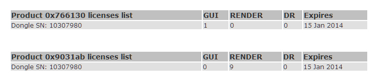

                Hi, i ask for and extended time frame on beta licence, upgraded the dongle licence, the same problem "could not obtain licence -200), check the licence server,
                Product 0x766130 Total Engaged Free
                Render licenses 0 0 0
                Interface licenses 1 0 1
                DR licenses 0 0 0
                so i remove dongle
                uninstall wibu driver
                download wibu
                install wibu
                plug dongle
                NOTHING HAPPENS.
                What can i do?
                Is it going to be the same with every release?

                  Originally posted by oligophant View Post
                  What can i do?
                  It looks like you are using an old license server (it says Product 0x766130)?
                  Vlado

                    And how i can get/use an updated licence server?
                    i attach what i see on the licence server page.

                    • #25
                      Is your license server the same machine you installed VRay 3 onto?
                      If not, you need to install the updated license server onto the computer hosting your VRay licenses. Once you have done that, all the licenses will work correctly.

                        Installed vray3 on my dongle pc, everything work as expect, but i have a question, if i want to work on 2.4, Do the licence server downgrade by doing that? or it keeps the new one. I want to test 3 on another pc

                        • #27
                          You should still have your 2.4 license and a VRay 3 license.
                          If the "other" pc is on the same network, just install VRay 3 on it, and then point the license to the machine with the VRay 3 License server, should be good to go. The 2.4 license should not be affected.

                          • #28
                            Well, the cookie crumble this way for me.
                            Main dongle pc (workstation)
                            installed vray 3
                            license server information, everything its as expected,
                            installed vray 3 on slave pc, everything its as expected.
                            i want to use vray3 on slave pc and work with 2.4 on main pc ( i have some projects going on atm)
                            deinstall vray3 on main pc and install vray2.4
                            license server information doesn't recognize vray3 licence, it says "Product 0x766130"
                            Seems that i cannot have vray2.4 and vray 3 on slave pc. Also i have only max2011, maybe if i install max2014, but for now i would like a workaround. Anyideas?

                            • #29
                              installed vray 3
                              Oh, I see; a bit unusual configuration. Well, one solution would be to install V-Ray 3.0, copy the file vrlservice.exe somewhere (it is in "c:\program files\chaos group\v-ray\3dsmax NNNN for x64"), install V-Ray 2.4, and then copy the vrlservice.exe file from the 3.0 installation over.

                              • #30
                                Thanks, i'll do that; the thing is that it worked fine with the previous release, so i got confused.
