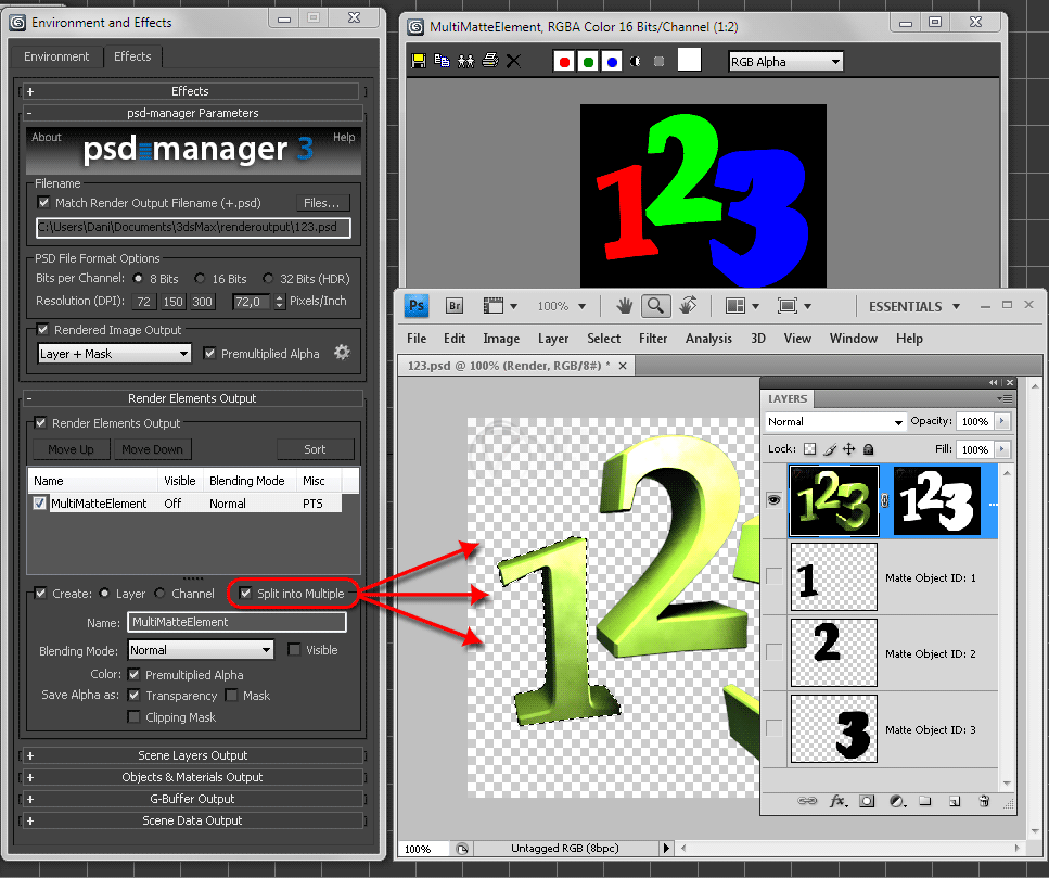

        psd-manager can automatically split-up the Multi-Matte elements into 3 PSD layers or channels. It figures out which RGB channels you actually used and names them accordingly. The latest version 3.2.1 also supports the objects-list in MultiMatte elements and creates layer names from the objects you added there.
        Daniel

          Yes was thinking psd manager was the way to go. Yes of course you can it with masks. the key here to help with the automation of updating files regularly. If the multimatte could be rendered out and the black background not be applied it would fit the workflow we are trying to achieve with smart object and Photoshop layers. Will need to try the demo of psd manager and see if it can do what we are after. Unless there is magical button we are forgetting to press to do it straight out of the buffer!
