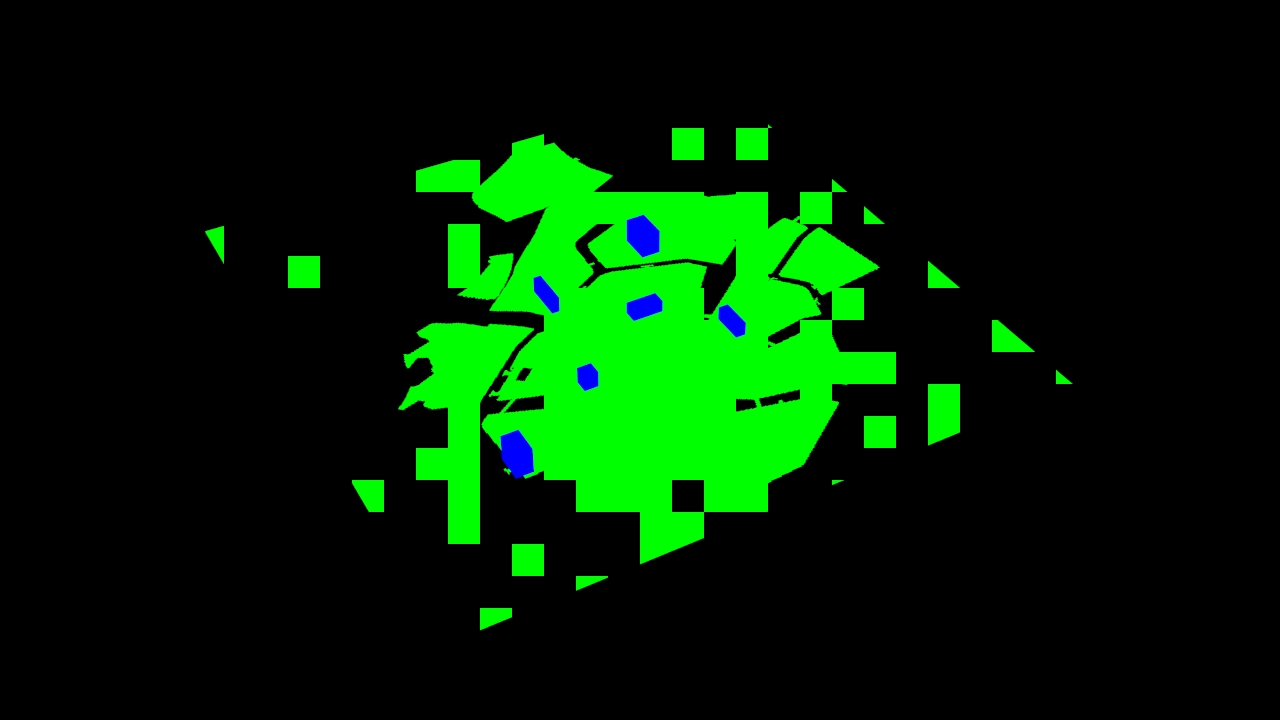

    Recently finished a project where this problem popped up:
    I'm using a AI file as a texture through the new VectorMap in max 2014, and wanted to have it affect the MultiMatte RE so I only get the opaque parts of the map as a matte colour.
    For some reason, my workstation can't do this, while the DR slaves can (rather baffling). All machines are running the same version of all software involved (latest update for max, and vray 2.40.04).
    In addition, the multimatte is sampled badly in the areas that work, and the alpha is strange, as it is only showing the boxes and not the plane as one would assume.
    I also wonder about how to get Vray to sample the vectormap better as seen in the samplerate pass.
    Can anyone please shed some light as to what I might have done wrong?
    Here are the passes, and a zip with the scene attached:

    Hmm. Reloaded the scene after lunch, and now the multimatte is rendering ok on my machine too.
    The sampling on the multimatte edges is still and issue, even after upping the min image samples to 3 (in a desperate attempt). Though at 3-16, the samplerate pass looks better in regards to the AI textures edges.
    I also found that in the RawGI pass, you can see noise differences between the blended materials for some strange reason.
    RawGI pass
    The alpha still puzzles me though

          Ok - alpha issue is related to Affect Channels set Affect All Channels both in Reflection and Refractions and at the same time both properties are turned off (0,0,0-color) - if you switch them to color only the alpha will be rendered fine.
          RawGI pass difference is something normal - brighter materials usually requires more sampling than the darker ones and that's why they are cleaner in the RawGI pass , you could fix that by decreasing DMC / Noise Threshold value or increase GI multiplier from VrayObjectProperties window.
          Still looking into MultiMatte Issue - will let you know if I find a solution about it.
            The alpha settings in the refraction was probably set as a mistake when trying to get the multimatte to work. Initially I had an issue where the base materials matID would override the blended ones. I later found out that the base material had to have no (id 0) matID assigned to get the correct result. Ideally I wanted the base material as red, and the AI plan as green with any extra stuff like the buildings as blue.
            Typically I forgot to reset those parameters as they seemed to have no effect on my problem.

              Hello trixian
              We haven't found a solution to this issue so far.
              We are going to upload the bug into our system and we'll let you know when our developers find a solution about it.
              Edit: It seems that the issue is related to 3DSMax rather than Vray - if you open the vector map into preview mode in 3DSMax you will see the same jagged edges like the ones in MultiMatte Element.
