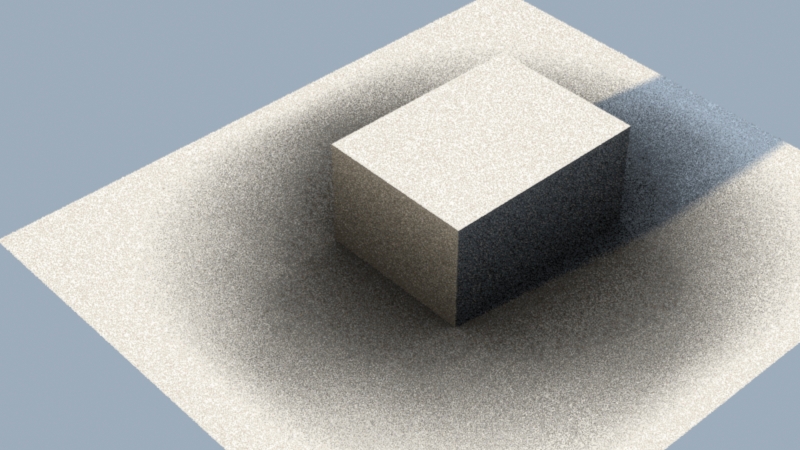

    Hi,
    i just discovered that color correcting VrayDirt map using output map does not seem to work in 2.40.04. As you can see on the attached picture, output without any modification of VrayDirt is identical to the output of VrayDirt fed through the heavily color mapped output map.
    This makes me very anxious realizing all my renders i did with 2.40.04 were rendered wrong (i wondered where all the detail went) and that all my materials i did while using 2.40.04 will look very different once this gets fixed. I used VrayDirt fed through Output map a LOT for creating procedural materials...
    I will have to fix a lot of stuff on the large project i am currently working on, let alone fix will probably take ages before next Vray 2 version is released... :/
    I am attaching also the scene
    EDIT: Forgot to add it is on Max 2014 SP3
    EDIT2: Just to double check it is really Vray issue, and not 3ds Max issue, i created the same scenario with Mental Ray and everything worked the way it should.
    EDIT3: Does not work though Color Correction node either.

        I don't think there's any bug here. Can you try using more subdivs for the VRayDirt map so that you get a clean result before it is passed to the Output map?
        Vlado
          Vlado
          1, I did try to increase subdivs, same result, just cleaner.
          2, In all previous vray versions, it worked perfectly... you yourself sent me an example of it... in this thread http://forums.chaosgroup.com/showthr...167#post573167
          3, As i stated above, i tried Mental Ray as well, and result changes dramatically when output map with same color mapping is plugged in.

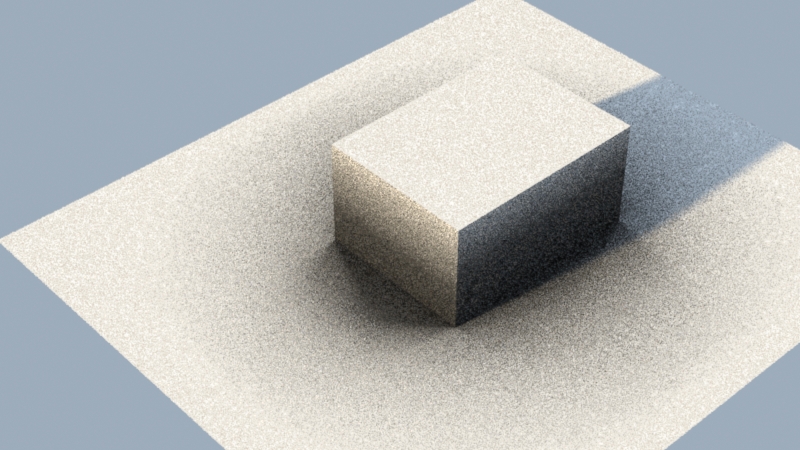

            Now this is funny.... This is what i got when i lowered Max DMC subdivs from 100 to 4... It is rendered on a SINGLE machine, with DR disabled... O_O

              Ok... so i narrowed down the source of that issue... color mapped VrayDirt behaves extremely unpredictably regardless of what amount of subdivs is set in VrayDirt when using Vray universal settings approach.
              EDIT: Examples:
              In all of the examples below, VrayDirt Subdivs are set to 64
              Max 4 DMC samples
              Max 16 DMC samples
              Max 32 DMC samples
              Max 64 DMC samples
              I guess sample division is really bad thing in this case, as it does not affect only quality, but also the look of an output.
                    For the VRayDirt subdivs to have any effect, they need to be more than the subdivs of the AA sampler.
                    It's good that we added that option then, isn't it The general problem is that one sample of VRayDirt is either black or white; whatever your Output curves are, the black will remain black and the white will remain white. You need more samples for each shading point in order to make any mapping meaningful. In order to do that with the universal approach, you'll need to increase the dirt subdivs beyond those of the AA sampler.
                    Vlado
                      Vlado
                      Ohhhhhhhhhhhhhhhhhhhhhhh... That's few of those things that are not written anywhere yet everyone should know... It is quite confusing when setting, which you expect to only affect quality/speed ratio, affects actual look of the image as well... It's nice that now we have option to disable sample division. It does not really bring that much of a performance gain, but it certainly makes things easier to set up.
