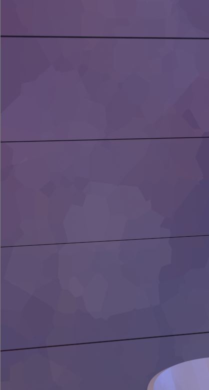

    Hello after 2 hours of rendering in progressive mode in BF+BF, there is no noise but some sploches like with LC+ IR method!
    Should I increase the light subdivision and material subdivision to get rid of itClick image for larger version

    Edit: Increasing BF/Light/Material and texture to 200 subdivision didn't solved the problem.

    Hmm - that doesn't look anything like light issues - have you got duplicate faces?
      I do have a geometry behind the front panel (the black groove) but It is not coplanar, it is 3 mm behind.
        Looks very strange... which pass is causing issues? raw light/raw refl/diffuse ? can you show other passes?
          Are all the materials in the scene vray materials?

            Hard to say what is going on... would be best if you can get us that part of the scene to vray@chaosgroup.com to see what's going on. It's very strange though - are you sure this is bf+bf?

              It was set to BF/LC, completely non sense!
