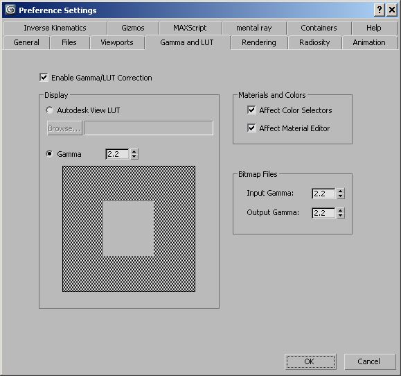

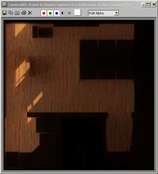

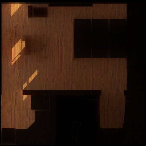

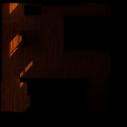

                  working without the vfb has eliminated my DR bucket gamma issues so far. but I'm stumped on this one particular issue which I wonder if anyone else has come across. my output gamma is set to 2.2 - my render looks correct in the 3dsmax frame buffer - but the texture saves in what looks like a gamma 1.0 output.. so unless I choose in vray, mode: color mapping and gamma - which gives me an incorrect image in the buffer, but looks correct when saved.
                  buffer
                  output
                  -or-
                  buffer
Name:	apt_geo_floorVRayCompleteMap copy2.jpg
                  output
                  either way, if I do a direct save from the buffer window, saving using the system gamma, it looks identical to the buffer image...

                    It seams that Output Gamma value is not taken into account when saving images from Render To Texture functionality.
                    I'll make a note about it into our system and will update this thread when we have some news on that matter.
