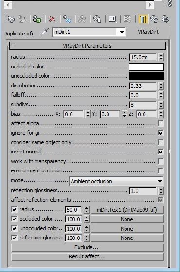

                      The same material is applied to all the 3 objects in the render.
                      VrayDirt Texture settings are in the image - with a radius of 15 cm
                      Test shows that thickness is taken into consideration and is not calculated for each face.

                        it's always been like this, it's because you're inverting the normals. you don't see it when the dirt is set up with that off because it's looking in the opposite direction.
