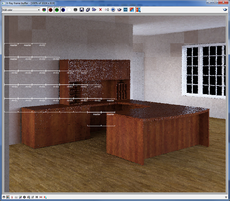

    I'm having an issue with some DR buckets that are rendering darker than the rest of the scene. It happens during the Prepass process affecting the buckets generated by my local workstation only. The two other render nodes seem fine. If I use a material override, the issue is gone. I tried turning "Convert local file paths to Relative" on/off, with no difference. "Convert to UNC" is off. So I don't think it's a materials issue, but what's weird is that it seems to only be happening to the top portion of the frame?

    I think that's normal so long as your final render looks fine. Does it?

      No. The render does not look fine in the end. Here's another example where I disabled the single HDRI dome light source and added a V-Ray Sun. Same blotchy problem throughout the image. Out of curiosity, I opened an another older project and tried a re-render and it looks fine. So I really have no idea what to think why this would be happening?

            changing bucket size has solved that issue for me; usually a larger bucket.

                      All of the V-RAY builds are 2.40.04 so that's not the issue. Also, both workstation and two render nodes are running 2014 SP5, so that's all the same. I also tried using different light methods (HDRI in a dome vs. V-Ray Sun +enviro map) still nothing. The issue happens throughout the seen, even on a vRayMtl with a basic diffuse color. The ONLY thing that fixes the issue is if I use an Override mtl with a basic diffuse color.

                      I just did another render, but this time, systematically deleting the windows. NO MORE ISSUES! With every window I removed, the issue became less and less pronounced until it progressively disappeared. Why would this be?

                          That's what makes this so frustrating to figure out. The glass is nothing special. Diffuse and Refraction of 255. I even hid the glass layer, same results. I've double checked to make sure there aren't two glass layers that I might have missed... So far, the ONLY way to fix the issue is to hide the windows. You wouldn't think that window frames/grids would be the cause. That's what is so odd. These are imported .skp windows from Google Warehouse. Maybe it has more to do with the limitation of the intensity of light when there's something present in the window openings? I'm going to try different windows in the meantime. Another odd thing I noticed is that the issue is more pronounced towards the top of the frame and fades out by the time the bottom of the frame is reached.

                            Just replaced the windows in the scene with something totally different, leaving the glass IN, and no issues whatsoever. Must be something really flaky with the grid windows that I had selected... No idea. Very strange.
