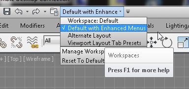

                    Hi again,
                    I have a few more questions about this issue.
                    Are you using the 3DS Max Enhanced menus ? Click image for larger version

                      Hi tashko...
                      Build vray_adv_31501_max2015_x64_25314.rar to vray_adv_31501_max2015_x64_25320.rar
                      Workspace default
