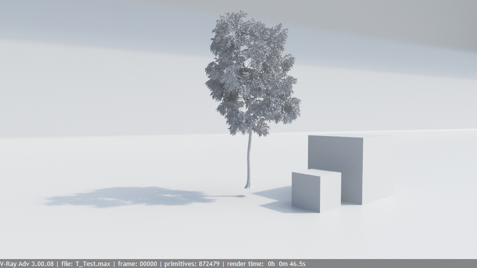

    I just realize doing some test, that Vproxy render about 2 time slower than original Mesh.
    I did try many parameters, but I can't figure out What is happening.
    Try To change from default to static or dynamic, increase Dynamic memory, enable/disable Embree.... no change.
    Proxy are not that heavy, Memory usage is very low in both case -+ 50 mo (Original mesh or Proxy) about 2.5 Go of memory
    Any clues? It is king of annoying because I have to render a full animation, and it will take Twice the estimated time.
    thanks for any infos
ID:	881042Click image for larger version

        Hi,
        I think the case here is different here. Would it be possible to give me more information about this proxy object? How is it created?
        Is it a Forest pack tree?
        Tashko Zashev | chaos.com
          V-Ray 3.1 is somewhat better at this, but in general when you create the proxy, there is an option how many faces to put per voxel - you can increase it to f.e. 100000 or more (newer builds also have an option "One mesh per voxel") - this will make the proxy render faster later on. Additionally, V-Ray 3.0 does not use Embree for proxies (whereas V-Ray 3.1 does), and it is another source for difference.

              With some luck, next week. For sedus' scene in particular, I got the following results:
              No proxies: V-Ray 3.00.08 - 2m 40s, V-Ray 3.10.01 - 2m 3s
              Proxies: V-Ray 3.00.08 - 6m 25s, V-Ray 3.10.01 - 2m 54s
              The proxies are still slower, but not as much as in V-Ray 3.0
