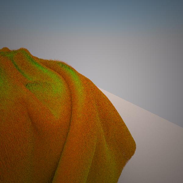

      I rendered this last night. It took over 10 hours for a 600x600 render! This has 100 strands per face, 0.1mm thick, 25mm long.

        I have a scene file with my throw model that I can supply. Should I email you direct Vlado?

          Best to email it to support@chaosgroup.com - the guys will check out what may be wrong.
          Vlado
