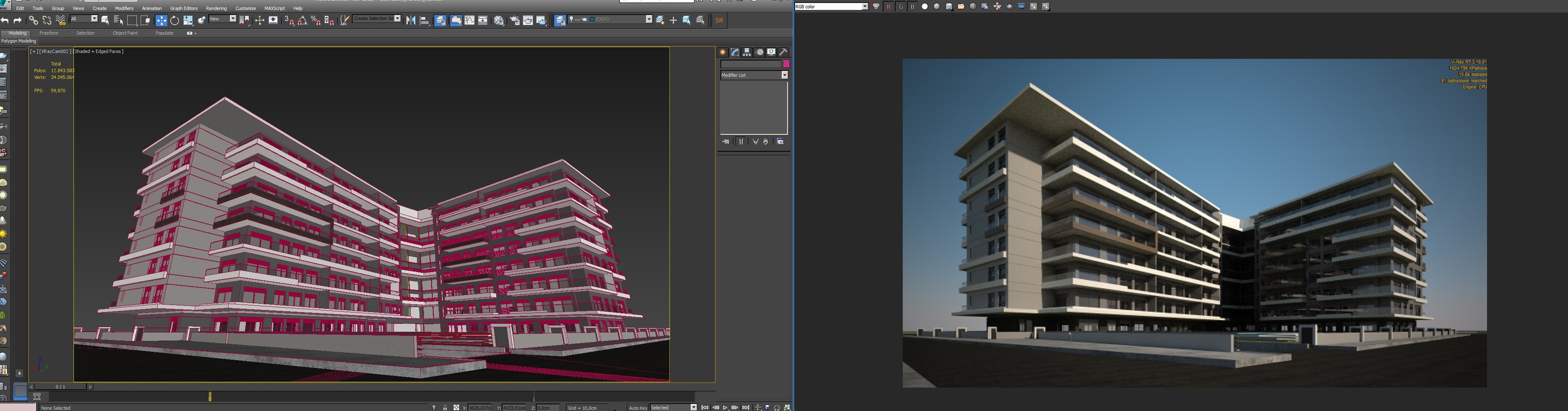

    Whats going on my cameras ? my vraycam giving different responses.Camera settings cannot be functioned in my viewport ??

      When I closed the camera target off problem solved. the problem starts again when I turn it on again.I want to change my camera settings but my viewport doesnt respond.
      http://facebook.com/Avisgrafik
        I guess your camera and the target are too close, please check it out

          the problem is not there.I try to create cameras in different scenes.

            Im experiencing a similar problem as well, altering the Vertical Tilt in the v-ray camera does not change at all in the viewport but when rendering its fine. Which is a little time consuming with running extra test renders to see if the camera view is correct to what Im trying to achieve.

                Im preparing to send the file shortly but on that I just noticed I had the main camera hidden through the display tab and when I uncheck hide cameras the viewport changes to the proper vertical shift on the camera and when I click the checkbox to hide it, the view changes again looking like there the vertical tilt was reset back to 0.0

                      After talking to Peter this morning it looks like it could be a max problem where depending on if the camera is hidden or not will affect how it behaves in the viewport. Tolgahan, do your cameras change in the viewport if you try to hide and or unhide the camera?

                            I think I've got the same problem here. Both in 3.10.01 and 3.10.02, vray cameras with vertical tilt don't show the effect if cameras are hidden. Only tested in max 2014 so far. But it applies both to old and new empty scenes.

                              Actually this is already fixed in the night builds. So it will be in the next service pack or even sooner..
