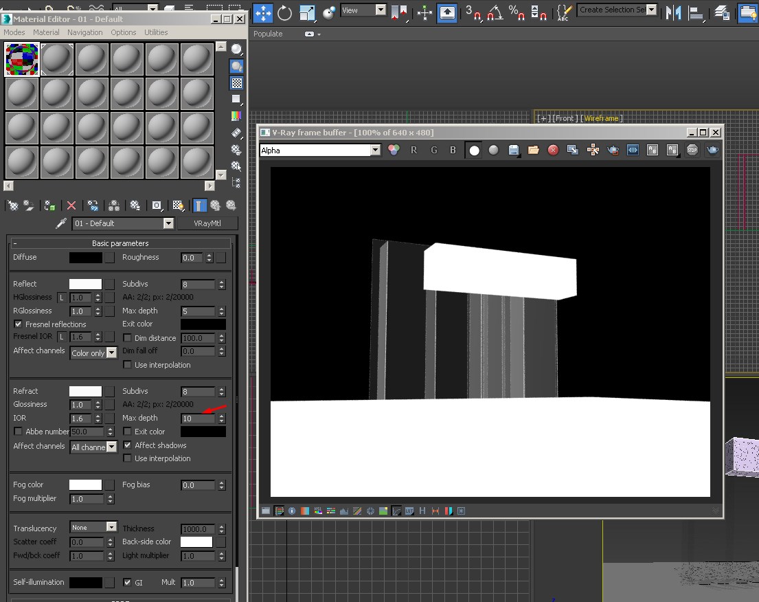

    So I'm having an issue with my glass and alpha channel knocking out part of objects behind. It's strange because it isn't consistent. Thanks for the help!
    Attached is the rendered frame, alpha and glass material.

    Try to use more Max depth for refraction, this should fix your issue.

      Perfect! Thanks!
