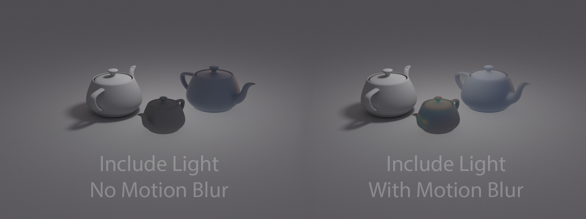

    I have come across some unexpected behaviour with the SSS shaders and motion blur when light linking is used in a scene.
    It is as though the light link is ignored for the subsurface component when motion blur is enabled on a VrayPhysicalCamera (Behaves when motion blur is enabled globally in the render settings )
    I have attached a simple scene image to highlight the issue. Images should be the same but aren't.

    Hi,
    Would it be possible to attache the scene for this issue ?
    Tashko Zashev | chaos.com
      Sure file attached
        Thank you very much.
        The issue is reproduced and forwarded to our developers. We will post a message here when the fix is available.

            Our developers managed to fix this issue and the fix will be part of the next service pack.
