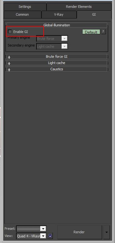

        Make sure that Engine Type is set to CPU from V-Ray RT settings, and GI is off from Vray Adv settings:
ID:	855346Click image for larger version
        V-Ray always uses GI if RT Engine is Cuda or OpenCL, that's why the exported scene is with enabled GI even if it is disabled from V-Ray ADV options.
