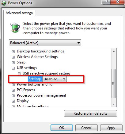

                Could you please try to disable the option "Allow the computer to turn off this device to save power" , from Device Manager > Universal serial Bus Controllers > Right click on each USB Root Hub
Name:	2015-03-16 10_12_14}.jpg
                and change the "USB selective suspends settings" in the Power Options according to the screenshot.
Name:	2015-03-16 10_10_35}.jpg
                If the problem still persist, please contact us at support@chaosgroup.com to troubleshoot the issue further. We will need the full spec of the machine, the exact software versions and a screenshot of the error you got (if there is any)
