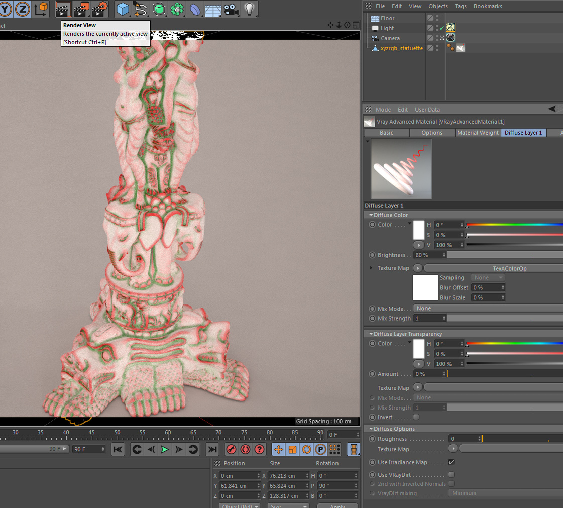

                      i do think at least some parts of the above shown things are possible already now with vray dirt, if you mix/blend 2 dirt shaders in a mix shader (i used "product" mode). one dirt with invert normals and double sided option on. i often use this setup to make things like shown above. normaly with texture s in the radius slots to add some grunge.
                      here a rough small test.one could texture the radius to make nice scratches/damages to the surface parts as in Neils nice examples above,
                      i made it simple here, just one dirt red, the other green to separate convex/concave and neutral(white)

                      this was made in c4d version, sorry, but same possible in max or any vray i guess.
                      that said i think it would probably be quite useful to have some of the boomers features/easy of use, i also like the tension map p.e, or also texture input for the curvature shader values

                        p.s.: the curvature shader would help where dirt fails due its nature, also in the above combination use, which happens when the thickness of an object is less than double the dirt radius.
                        so actually i think it is important to have a curvature shader having similar features as vray dirt (or add a "curvature mode" to dirt mabye?)
