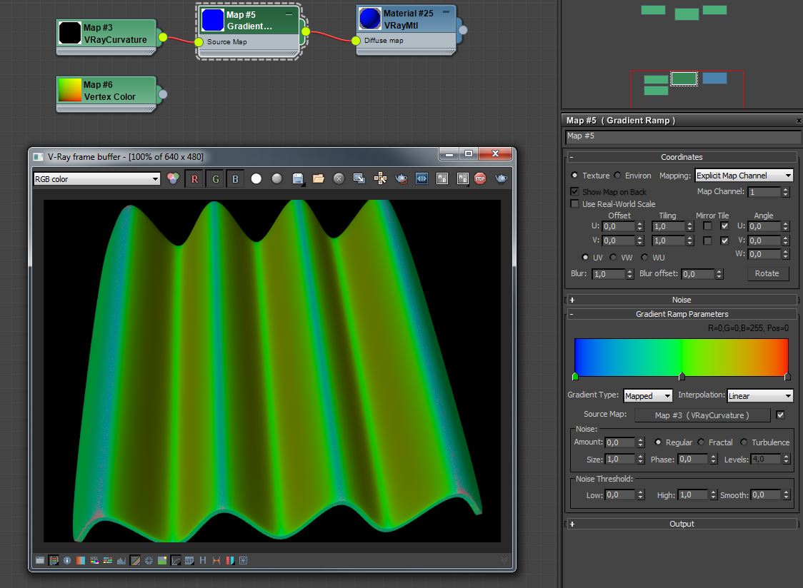

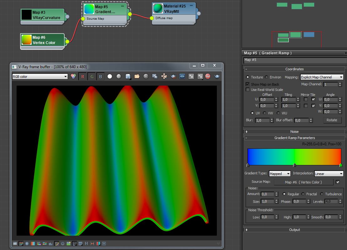

            There is possibility to transfer curvature to vertex color using MCG:
            http://area.autodesk.com/blogs/chris...creation-graph
            Here is comparison of MCG and Vray curvature:
Name:	MCG curvature.JPG
ID:	856222 Click image for larger version
Name:	Vray curvature.JPG
            I think there is something wrong with Vray curvature map.
            Regardless of value of "Sample spread", I get results which are just wrong in my opinion...

              Originally posted by Mnietek2707 View Post
              I think there is something wrong with Vray curvature map. Regardless of value of "Sample spread", I get results which are just wrong in my opinion...
              The result is correct for the way the shader is coded to work (by shooting feeler rays around the shading point). Whether this works as you expect or not is a different matter; for the moment there are no plans to change it.
              Vlado

                • #23
                  Yup, the vraycurvature shader should be producing red at the concave parts and it isn't. Good test.
