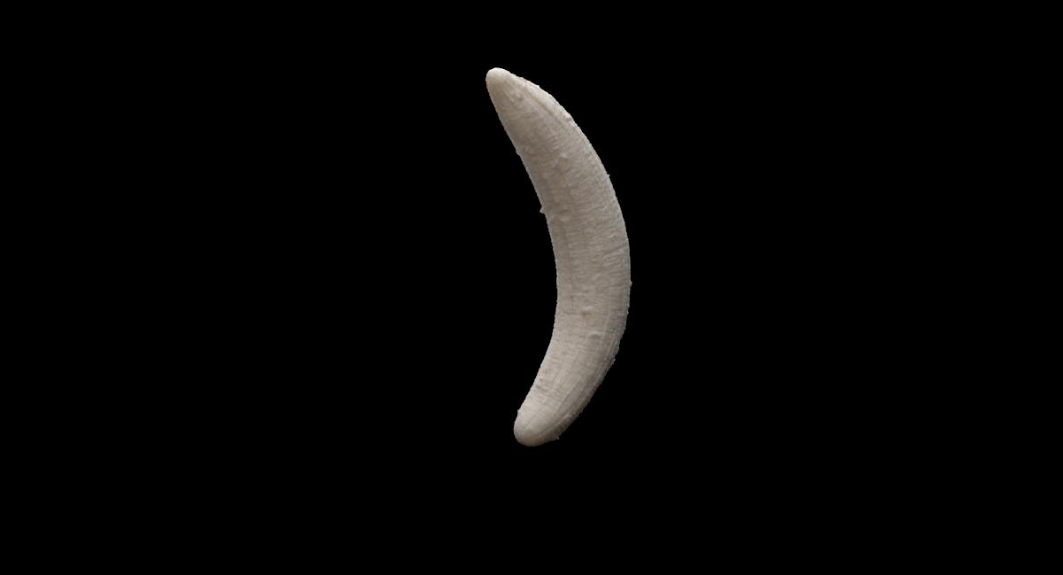

My problem is as stated in the topic. I have planes scattered on a object. These planes also intersect the object leaving dark spots.
The main object has a fastsss2 material while the planes that is scattered has a vraymt material with a high transparency (refraction)
You can see the setup in these images.
The scattered planes have 100% refraction in this test renders just to show of the dark spots a little bit better. in the final render i hope to put the refraction to 50% or so just a get a nice "fury" look along the silhouette of the banana.
