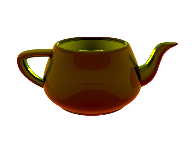

    It's actually pretty easy, yes.
    This is what i got in three minutes of playtime.
    In order: on the side of the light, on the other side, and from the top.
ID:	857913 Click image for larger version
ID:	857914 Click image for larger version
    The shader (base concept only!) is attached as material library.
    Notice you will have to choose the light you want the glass to react to, in the (twice instanced) falloff map.
    Let me know if something isn't quite clear.

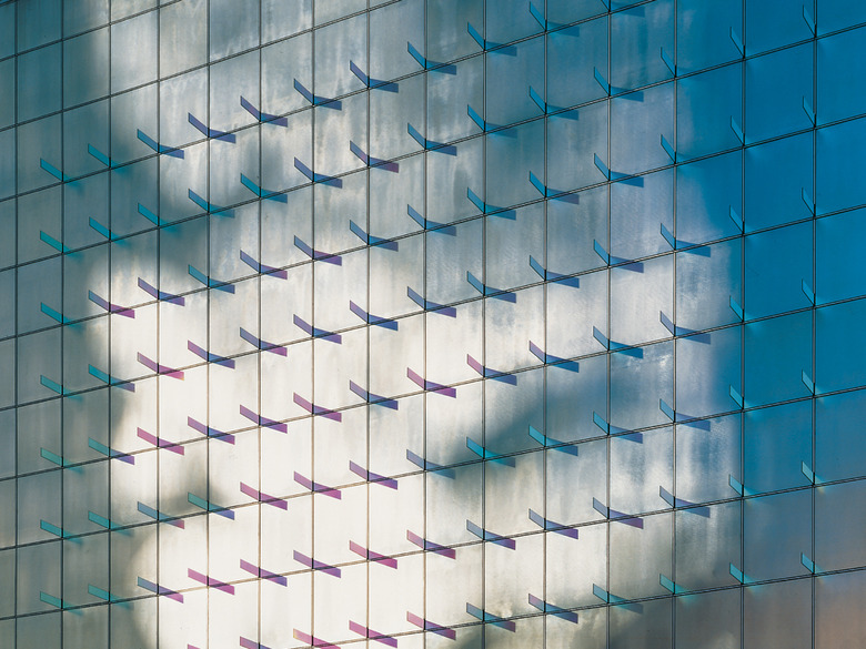

        i was trying to reach this effect (image). Its a project from james carpenter, and he uses the dichroic glass to achieve a color. And this color changes thanks to the direction of the natural light.
