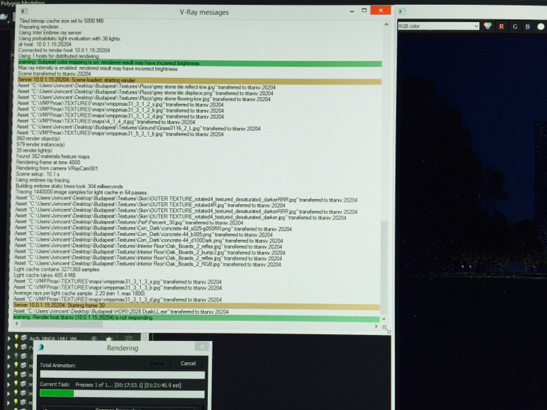

    Hello her is a picture of what I am talking about. So I think the issue is with the trees in the scene. Which is really not that many but if I turn them off the DR node joins. If they are on it hangs after transferring the last asset and never joins.
    What I am trying to resolve is this a issue with Laubrek trees (the plugin is installed on both) or is this a issue with the node having a hard time loading the geometry. The second does not make a tone of sense it's a Mac Pro 16gb of ram dual six core.
    The scene will then find the node again and reload everything but never seems to join the job. I have reached out to Laubrek but was wondering if anyone has had this same experience.
    Thanks, J
