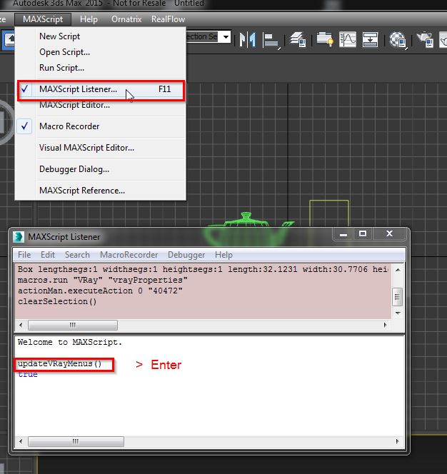

    Try to execute updateVRayMenus() from the 3DS Max listener to get them back, but that is strange indeed.

      thank you for your reply. Max 2014, V-ray 3.20.03 Where is this "listener" you speak of?
      Timothy Saunders
        Menu / Max-script

        Tashko Zashev | chaos.com
          I just reinstalled v-ray, and it looks good.

              I just had a similar situation, after a while of trawling the internet for fixes that link provided the solution. Thank you for the fix this bug is a killer The menu or Vray object properties was not eve available in the customise user interface menu options
