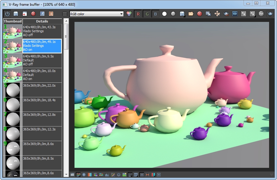

              Btw, that AO amount shown in that picture is at a 4.0 multiplier.
              Usually I keep it at 0.6 to keep it really subtle, but I can't see it below values of 2-4. Vlado or someone from the team, can you comment on what is affecting the strength of the AO in the GI settings? Usually it's way too strong at .8, in this case with Vlado's settings, it's barely noticeable.

                    I've tried to replicate that issue on a very simple scene but according to my tests AO gave the same results with the default settings and the suggested settings from Vlado, here are some examples:
                    Default Settings / AO on: Click image for larger version
                    Vlado's Settings / AO on: Click image for larger version
                    Default Settings / AO off: Click image for larger version
                    Vlado's Settings / AO off: Click image for larger version
                    Scene: http://ftp.chaosgroup.com/support/scenes/ao_test.max
                    There might be something else specific in your scene which cause that difference so if possible please pack it and send it for investigation.
                    Originally posted by MoonDoggie View Post
                    Oh man, Probabilistic lights was on, forgot to turn it off. Let's see if that's the issue. Ps. it really doesn't seem to work and it doesn't seem like it should default to on.
                    Does the brightness difference disappear when Probabilistic lights are off?

                      For some reason, I didn't get informed there was a new post here and thus I haven't checked this thread in a couple days. Thanks for taking some time to investigate and attempt to reproduce this issue. The brightness difference is gone when probabalistic lights are off (so that's great).
                      I'll see if I can reproduce this locally with a stripped down scene.
