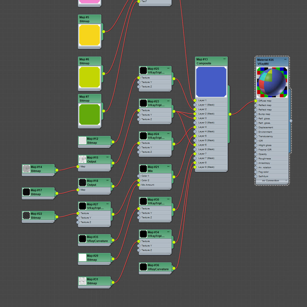

    I have this shader with several textures and triplanars (+ a curvature) connected to a composite node that's connected to the diffuse. Everything works fine. As soon as i try to add refractions it completely ignores the diffuse component and all the triplanartex... Same happens with a 2sidedMtl...
    Shader looks like this
    Is it a known issue? If not i can send a scene.

          Sorry for the late response. Displacement actually works fine, but the refractive shader still has the same problem.
          Sent the scene to you.
          Max 2015, Vray 3.35.01 nightly
