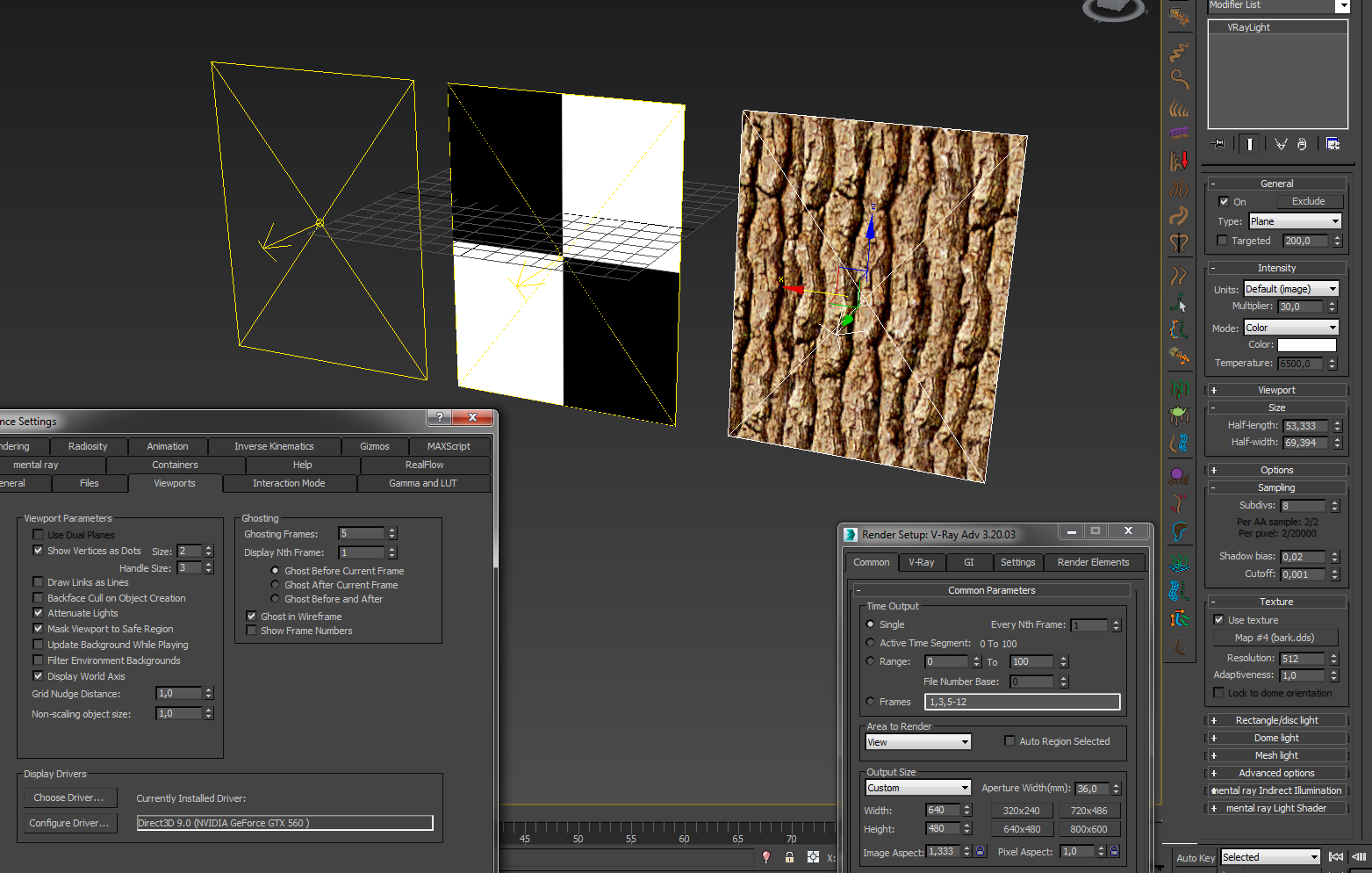

            I did a screenshot of my setup:
Name:	2015-11-25 15_52_56}.png
            Please check again the viewport driver selection.
            Tashko Zashev | chaos.com
              Ah, my apologies, totally forgot we switched to Nitrous for the 2D Pan/Zoom, when I switch back it works - sorry for the confusiuon.
