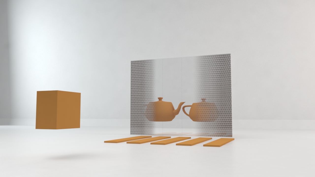

    I try to make a Texture that include An Opaque to Transparency and Pattern to no-Pattern. So I use A VrayMultiSub to help me assign different gradient to Face And be able to control what I Want.
    The result is Good, Except I got A very thin line of transition, visible in the most transparent part.
    In fact it is not that a problem because it mimics and joint between to Glass. BUT I want to be able NOT to have this line.
    Attached files, Rendering, showing the two thin lines, Map explanation, and Zipped Max File.

    The issue seems to be due to the usage of material IDs and gradient ramp. Anyway is there a reason for this complex shader setup. You can easily achieve the same shader with a few nodes like in the example scene here: http://ftp.chaosgroup.com/support/Transparence_Test.max

      The reason is that we have like 10 differents Transitions (opaque to transparent) to manage in the scene, All based on a single material. So with 10 differents setup we will have to each time change every single material one by one.
      With This setup, We only have to Add/assign a different ID, and Voila, new Gradient, new transition BUT same Material.
      The other Thing Is We baked the MAterial UWV on POLY, so We are able to control the size of the transition only by moving Vertex.
