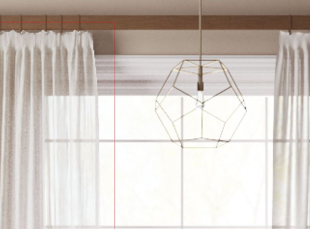

        I still have problems with jagged edges/stepping/aliasing when using Render Mask with Progressive Sampler. If I render it with Bucket Sampler instead of Progressive the edges are perfectly smooth.
        Please see the screenshot below and notice the jagged edges on the left curtain compared to the right one. Vray version - check signature. This is not related to the use of Lens FX, I don't have them enabled in this image.

          Hello,
          We haven't yet come with a nice solution for the render mask edges and the progressive sampler. For now there is only a warning about the problem.
          Yavor
