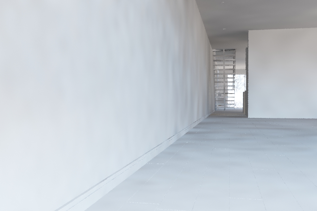

    Installed the latest vray and weirdly im having some issues...... could be me or something but what are those dark black patches? I did a clay render (material overide) and its doing this?

    That's strange. I've also installed the latest Vray but I don't have such problems. Can't say much without posting render settings or light setup. So this exact same scene rendered fine before you installed the latest version? It looks like your Irradiance Map settings are way way low or something. Can you try setting your production rendered to Scanline and then back to Vray to clear all render settings of Vray? Then set your GI settings from scratch and see if it helps.

        I removed the wall to the right - problem gone.... perhaps a GI issue? couple of screenshots below.
        I reset vray and still same thing. Havent tested on previous versions and yes, the IR settings are very low, but even on high its doing the same.

        @glorybound, good potential solution but no, no double geometry.

          You said you removed the wall and the problem is gone. That's because more GI samples are able to fall in that area without that wall blocking them. To me it looks like a problem with light setup. How did you set up your lighting? Can you post a top view screenshot in wireframe mode? Does it happen with other scenes or a simple one? If it doesn't, then problem is with this particular scene. If you are able to post the scene here, that would be a huge help in pinpointing your problem.

            Remove your glass windows and render for a test. Might be that you don't have affect shadows on for the glass window material and are not getting sufficient light and GI into the house.
            Try resetting vray settings, you might have render final image turned off. looks like your rendering out only a LC or IR map, especially since you don't see any contact shadows.
              Thanks so much for the response guys - will do some testing tomorrow when i get to it and report back. However after quickly reimporting the scene from scratch (sketchup) and doing a clay render with merged lighting/cameras from the problematic scene gives the results i expect without the black artifacts. So there is something weird going on. I will do more testing tomorrow.
