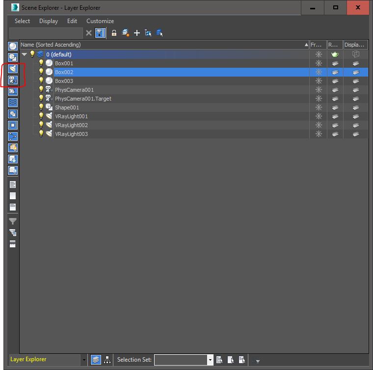

          I've read somewhere that the flickering key symbol is because you've cloned a camera (instance). If you make it unique it stops flickering. Just the other day I had that 'problem' and I instanced my camera et voila it stopped flickering.
          A.
          www.digitaltwins.be
            I can also see that camera and light filters are off (left side) so it's normal you don't see them
            A.
            www.digitaltwins.be
              sometimes off and sometimes on. My lights and cameras are missing either way.
