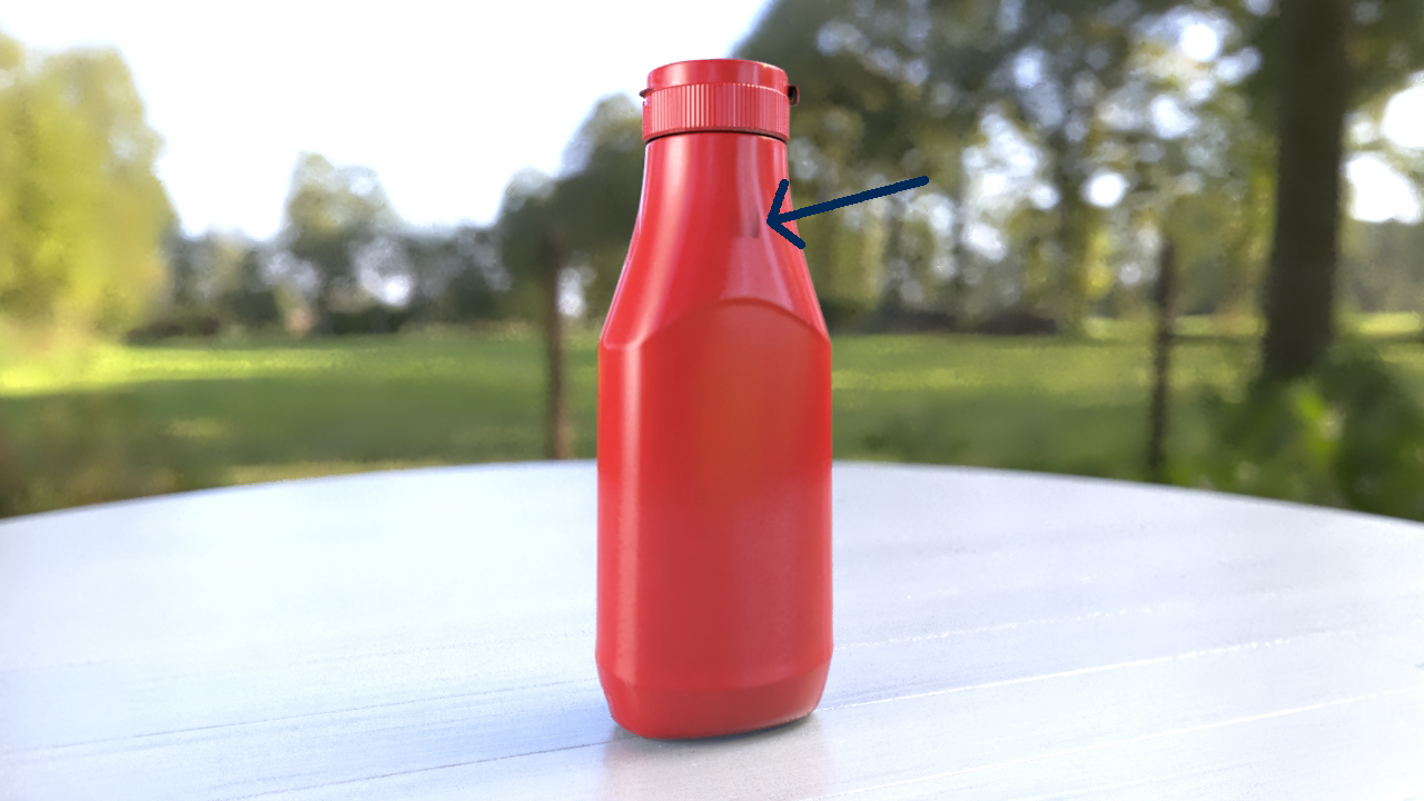

    I have animated deforming mesh. When rendered with motion blur I get artifacts:

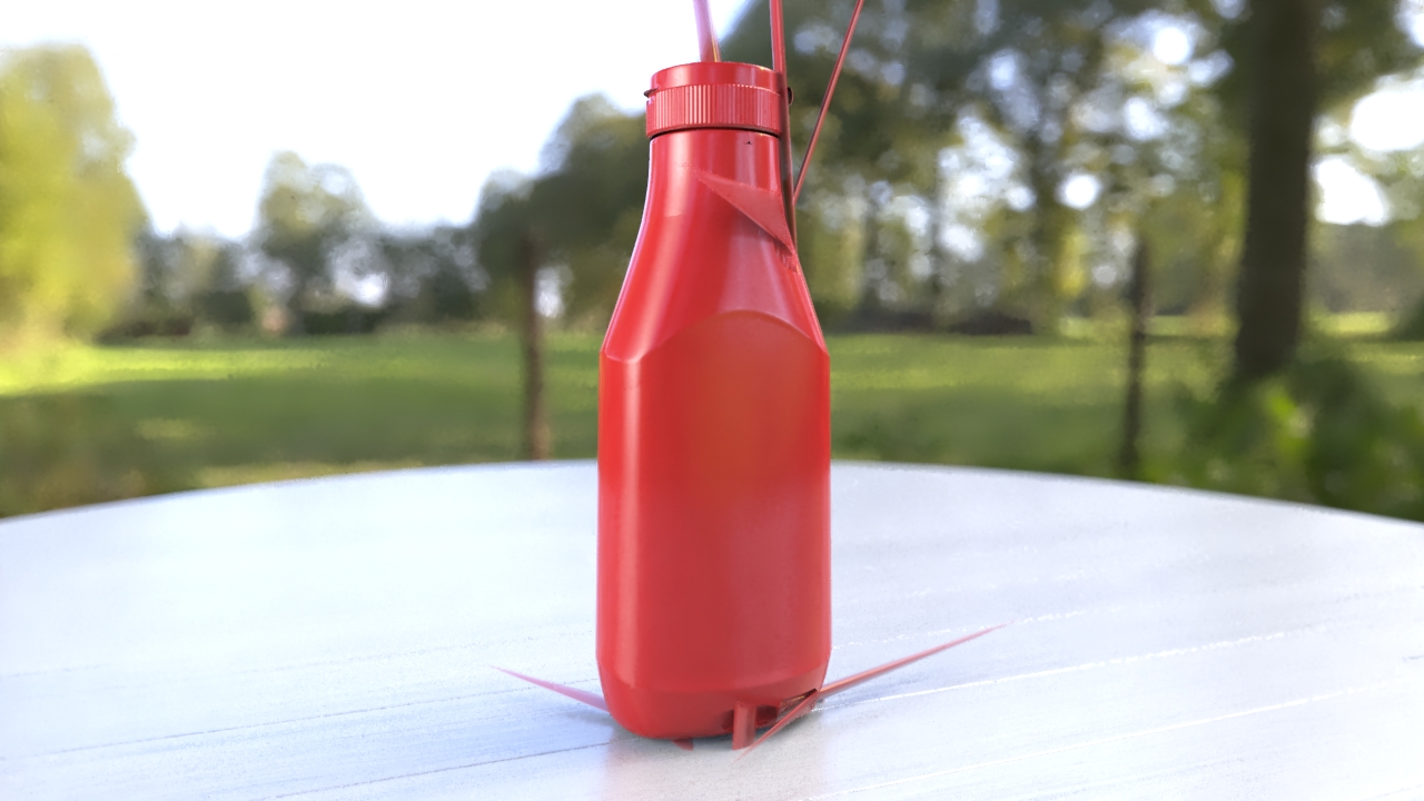

    so I export it to animated VrayProxy and get something like this:

    What kind of mesh is it (mesh or poly)? How is the mesh animated? Does it work better if you point-cache it?
    Vlado
      Mesh is animated by morphing and skin modifier.
      I didn't try point-cache...
      I can send files tomorrow if you wish...
        Vlado - I send link to files to support@chaosgroup.com
          Thanks for the scene, it looks like there is something wrong with the Vertex Weld modifier or the way we handle it.
          I completed a few sequences without it and it looks like it renders fine without it, would you please try to disable it and see if the issue disappears?
