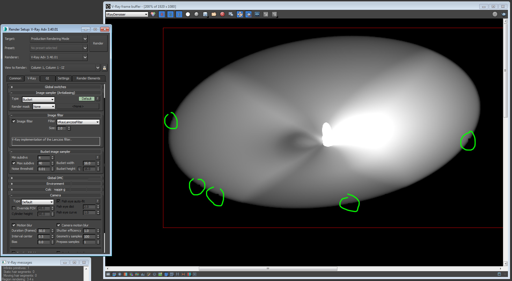

                  Could you suggest the kind of settings you'd expect to have to push to for something such as this as I am still getting missing buckets even with min=4, max=40. As I haven't really changed the minimum from anything but the default of '1' for many years, and we have rarely, if ever used motion blur in our work, I'm not sure what I should be expecting.
                  Kind Regards,
                  Richard Birket
                  http://www.blinkimage.com

                      Originally posted by Morne View Post
                      try min AA of 2 or 3 and make your bucket size smaller. Bucket size of maybe 10 or 8?
                      So is changing bucket size part of people's workflow to achieve 'correct/proper/good' results then? I thought bucket size was purely concerned with render efficiency (i.e. the way something is divided up between CPU cores)

                        ...increasing min samples can help.
                        EDIT: Vlado recommends making buckets larger

                        • #13
                          Smaller bucket size might help in this situation. Since those camera rays will be shot in a smaller area, the probability for them to hit the moving object are greater.

                          • #14
                            hi,
                            i`m coming across this black square issue on helicopter rotors a fair bit now. what`s the solution, as raising min aa/smaller buckets isn`t solving the problem. only rendering with noise threshold of 0 or using progressive or fixed seems to work but that comes at the cost of slower render speed. it means i can`t benefit from adaptive rendering speed benefits now ?
                            is there a solution ? will there be one ?

                            • #15
                              I think Zdravko meant *larger* buckets, not smaller ones. Smaller buckets are likely to make the problem worse.
                              We have only two solutions to this problem:
                              *) Increase the min. AA rays and increase the bucket size, or
                              *) Use the progressive sampler.
                              This is just a tough case for the bucket sampler to resolve.
                              Vlado
