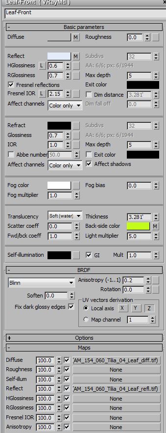

        Here are some settings, these are evermotion models use as is, i noticed now that translucency is also being used which i usually don't use but this particular set of trees is have had to use for a specific reasonClick image for larger version

          this has pretty much always been the way with vray.
          though it got improved a lot with different modes.
          try Stochastic, or clip
            What the others said, try Stochastic or Clip opacity mode.
            Vlado
              Clip mode for stills, Stochastic for animations.
              for m in (getclassinstances vraymtl ) do
              m.option_opacityMode = 1 -- 0 for normal mode / 1 for clip mode / 2 for stochastic
