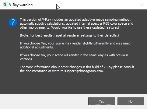

          Did you update the render settings when you open the scene with the newer version:
          Some of the features in the newer version are updated and will be calculated slightly different than in the old version so small discrepancy is actually expected behavior.
          There is always a possibility for a bug so it would be nice if you could provide that scene for investigation.
            Hello Svetlozar,
            it doesnt matter if i choose yes or no - it alwas renders like in the screenshots from above.
