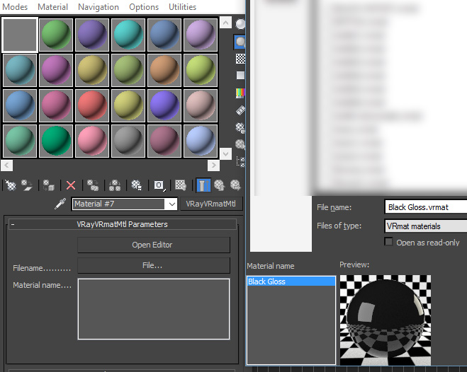

                              OK here's a sample of one of the vrmats.
                              When I select the vrmat to load, it gives me a preview of how it should look. Which is correct. A nice black glossy ball.
                              In the max material editor however, I can see that it is not looking correct. More of a washed out black
                              If I then open the Editor, I get the correct nice black ball when I loaded the vrmat, but as soon as I click on "Preview" the ball changes to the same washed out black as in the max matrial editor
                              This is a simple example. When there's textures invovled, most of the vrmats have been setup wtih maps that in the editor is set to either "linear" gamma 1, or "gamma corrected" gaam1 1, instead of the expected "sRGB"
                              If I set the textures to sRGB, then the file is correct max, but because the VRay editor is LIMITED, there's no quick way to do this across 246 vrmat files.
                              In the example above, the black gloss, I don't see a gamma setting so not sure how to set it.
                              It would be great if Lele or some other clever person can write either a maxscript, or batch script, to edit the gamma across miltiple vrmats (which is just an XML). Or if we can get an update to the VRayVRmatMtl with an override gamma setting
                              Here's the VRMAT

                              Oh and my Max gamma is setup correctly for LWF. fileingamma and fileoutgamma is 2.2. All normal VRayMtl and textures show correctly, just all VRMATS are off
