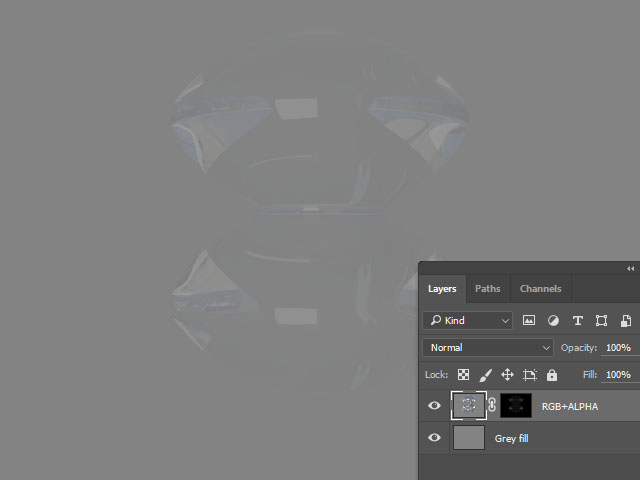

    Apologies if I'm looking at this wrong or answer should be super obvious (and please correct me if so), but the following doesn't seem correct.
    Glass-like material complete render, and one with a grey box behind, looks fine until you take into account the alpha...
    Alpha with reflections and refractions affecting all channels:
    Above appears too dark? Resulting in overly transparent image:

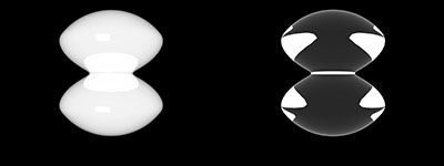

    Whereas the two alphas individually rendered appear more correct:
    First, alpha with reflections affect all channels, and refraction color only ...and... Second, alpha with reflections color only, and refraction affect all channels

    ...I can composite/matte separately, but it seems like I'm working around a strange issue... or am I being dumb?
    Thanks!

          Shouldn't the a combined alpha look something like this?
          (Similar to adding the 2 alphas but actually done with via the rgb + pure white environment/reflection)
          +In the original setup we'd want something like the above as an alpha, with rgb result being unmultiplied? ... Or is that around the area that v-ray runs into trouble?
          Is there no way of getting at that point/info/result from the renderer? At the moment we seem to be compositing the rgb and tracing/matting in one of the 2 alphas as per effect channels option?
          And when setting both refract and reflect to effect all channels/alpha we end up with something that looks like one of the alphas almost takes away from the alpha result?
          ... The rgb channel remaining blind/unaffected by the material option/process...?
          (You'll have to excuse the accuracy - or lack thereof - of how I *think* this maybe working or not).
          ... Is it not possible to modify or correct this result?
