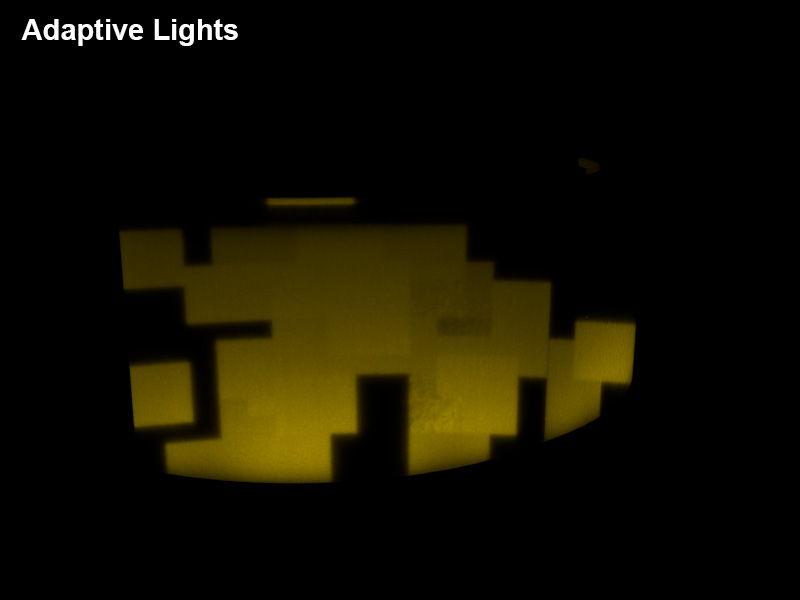

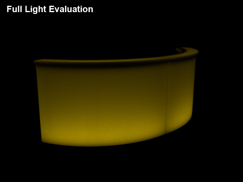

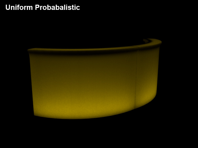

    I'm getting strange results when rendering VrayFastSSS2 materials with Adaptive Lights. Please check the screenshots below as well as the 3ds max scene for inspection.
ID:	886075 Click image for larger version
ID:	886076 Click image for larger version
ID:	886077 Click image for larger version

            Can get me some more specific reproduction steps? It seems to work fine for me in a simple test.
            Vlado
              Vlado
              Please check the attached scene (don't use the one in my 1st post, I forgot to set it up properly for the test). Just load this new scene in Max and hit render. I tested it on 2 workstations and on both Vray renders the SSS object with black patches like in my first post if Adaptive lights is used.

                Ok, yes I can see the issue. Like I said will fix it; in the meantime you can use the VRayALSurfaceMtl material.

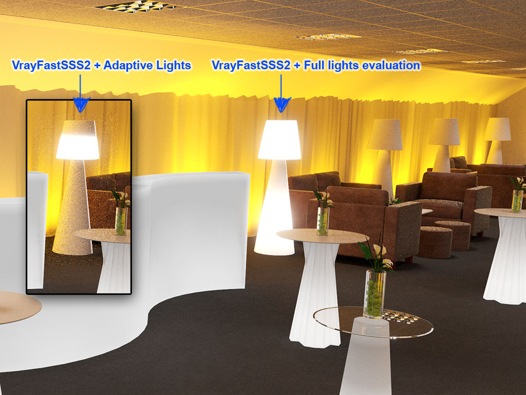

                  Now that the changelog of Beta 2 is released, I took a quick peek at it and found a couple of things that are still not working for me. One of them is the problem with VrayFastSSS2 materials and Adaptive lights. Maybe I'll have to check out the ALSurface material as a workaround for the time being as you suggested.
                  The image below is a test with Beta 2:
