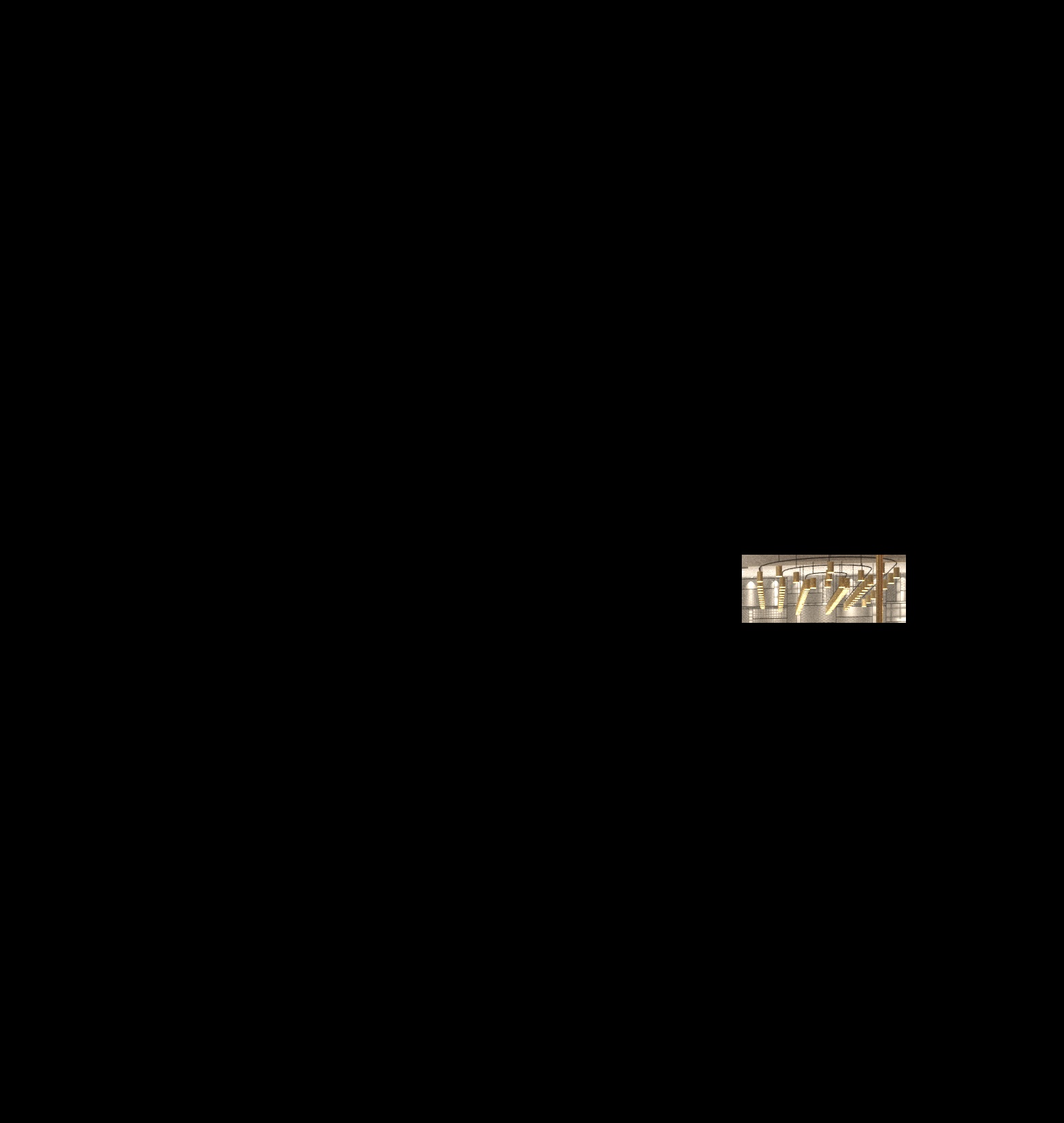

    some of the IES vraylights is missing on normal render, but they appear only on region render???
    many thanks
    Johnny

    Try increasing the LC subdivs

      perfect.... thanks
        did it work the @slizer suggestion?
          yes it worked but I have to increase LC to 2000.
          also worked when i switch off Adaptive lights with very low LC.
            I've asked because first solution I thought was to disable the adaptive lights... did you tried to leave the LC samples as before and turn off only the adaptive lights option?
              Why would you want to do that? I don't have the scene but I would bet that increasing the subdivs and leaving AL on would be better for the rendertime instead leaving them low and turning off AL.

                Cause I've never thought that the number of samples of the LC was the reason for that kind of issues...due to my ignorance on LC, as it seems...

                  just did a quick test, AL on low subdivs render time is lots lots quicker than AL off high subdivs.
                  thanks guys
                    thanks guys
                    Read my post again
                    If you want the IES problem solved and a quicker rendertime than the alternative (low LC subs and AL off), use AL on and high LC subdivs.
